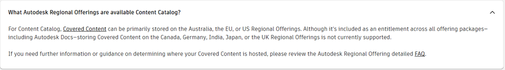

@Ric_Weber , @ThierryMonteyneSBE ,
From the Content Catalog site:
I will check to see if they are working on the other areas and if this Idea should be marked as Accepted. Thank you for your Idea submission!

Do you have the latest extension installed? Content Catalog Help | Revit Extension Release Notes | Autodesk
From the release notes:
  • Content Catalog detects your Revit Cloud Model’s region and opens in the appropriate location, providing a smoother and more seamless content experience.
  • For local models, Content Catalog now offers a manual region selection option, giving you more control over where your content is sourced.
