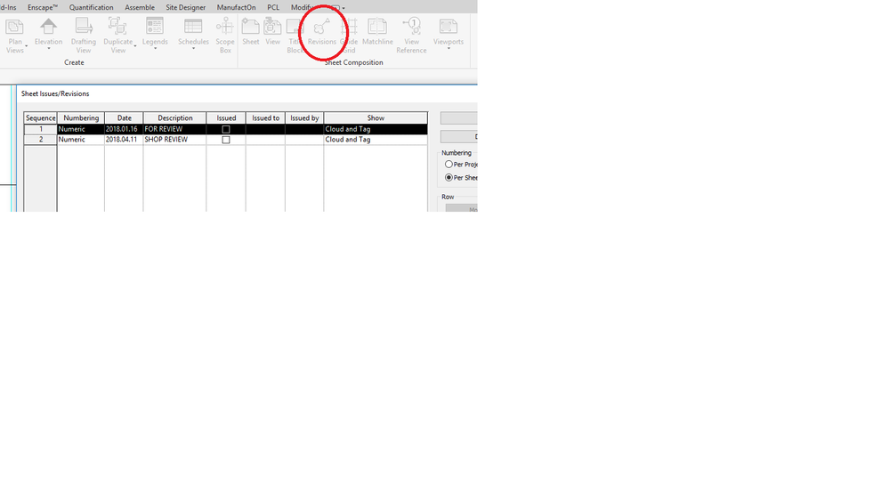

Another basic functionality to the revisions on sheets could be added - the 'Revisions on Sheets Button' should not disappear when selecting multiple sheets so we could change the revisions on multiple sheets with two clicks  instead like now have to click  each sheet individually and change revision.

I don't think you're understanding the issue I'm presenting here. I understand that you can modify a sheet family but I am trying to reference information in a project so I don't have to edit a family. I think that was the point in Revit having the Revisions added to the software. It seems like an unnecessary work around for something that should be easy to do.
Above is the tool I am referring too.

Xrev Uprev is a free add-in that does what you are asking. I use it to apply a revision to a selection or all sheets once the revision has been made.
https://www.xrev.com.au/products/Xrev-Freebies

I'm using revit 2019 and can only assign one sheet per revision. It would be good to see revit allowing us to assign a revision on multiple sheets by selecting sheets from project browser & click edit button (Revision on Sheet) from the properties palette.

  1. Set your revision up in the Revision Dialog, leave it with 'Cloud and Tag' on.
  2. Go to any sheet you would like to apply this particular revision to.
  3. Drawing a revision cloud of any shape (we are going to turn the revision cloud off at the end so it really doesn't matter what this cloud looks like or how big it is).
  4. Once the cloud (with the correct revision) has been drawn and finished, copy it to your clipboard.
  5. Then use the 'Paste to Selected Views' command (we have ours on a keyboard shortcut for ease (PV)) and choose the other sheets you want to the revision to be applied to. Use Ctrl to select multiple (you can also hold-click and drag).
  6. Hit Ok
  7. Go back to your revision dialog and set the 'Cloud and Tag' to 'None.'
