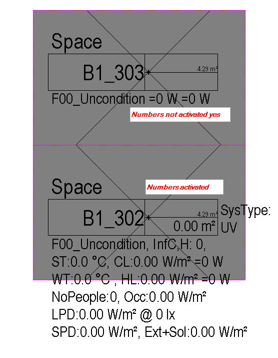

Reset Numeric parameter value back to 'empty' - for an Integer parameter to be blank instead of showing "0" (zero), with steps to reset to null if it's not a built-in parameter?
