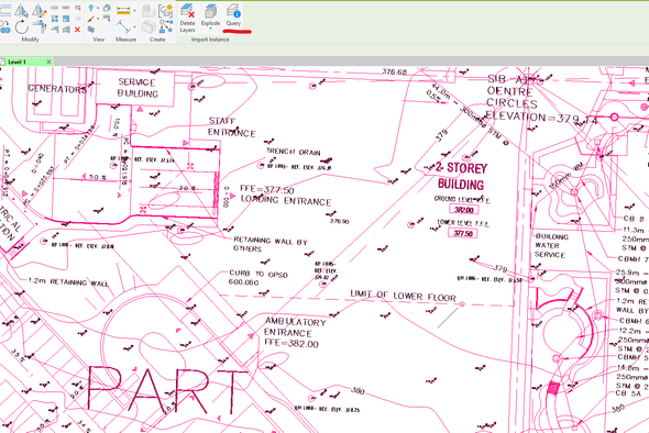

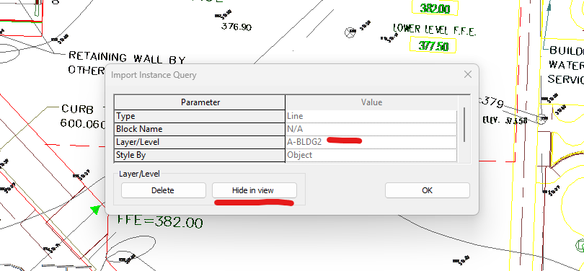

Currently you can hide layers by using the query function when selecting a dwg in a view.
Then when you select a line in the dwg it will tell you the layer name and give the option to hide (turns it off in VG) or delete that layer.

@Mike.FORM Thank you for your suggestion. I was aware of this feature, however using this button will unfortunately only hide the layer if you are not using a View Template. It would be a huge improvement if it did also hide the layer for your current View Template, but that would be a different feature than the one requested here.

@sdraak - 100% needed.  We have Plant 3D models linked to our Revit models and the Plant 3D models could have 100 Xrefs, which means that layer would need to be turned off using Import Instance Query 100 times. If we had a Layer Search Bar, we could search for all layers and then uncheck all of the boxes next to the layers we don't want to see visible.
