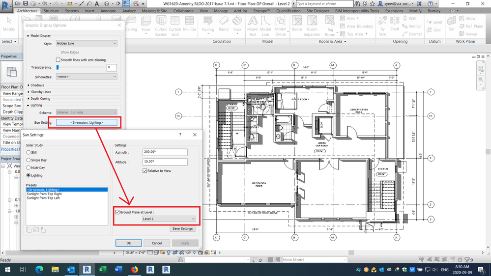

I've been struggling to figure out why my shadows are only showing up outside the walls of this house, and I think I've narrowed it down to the floor. When I add a floor, the shadows cast by the interior walls are no longer visible. I'm a bit of a beginner at Revit, so I'm not sure what to try.
1. Floor is drawn at Level 2
2. Walls are drawn at Level 2
3. Shadows are set to be cast at Level 2
4. This happens on the floor plan view and the 3D view
I've attached images of flooring drawn, and one with it removed. It's also worth noting, we're working with Design Options in this project, though that doesn't seem to be affecting it, and I'm working in Revit 2021

Check your View Range Settings.

JM_K
Emily,
Can you do a screencap of your Viewrange settings?

syman2000
Can you check what level shadow is set to?

emilycross
Yes, the shadows/ground plane are set to the correct level.
