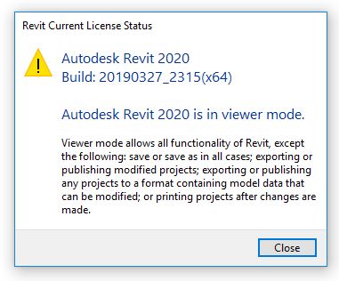

I was asked by the Twitter support team to post it here, so here goes.
I downloaded and installed Revit 2020 today and as every year I am excited to see the new stuff. But the first ting I noticed is that I can not save a project or a family and Revit pops up with a message telling me I'm in Viewer Mode (see attached image). I already tried logging out and back in again and of course rebooted my workstation as well.
Any idea what going on?

    • NO, it just started right on up, logged into my account, and in the manage license it shows my valid license. Also, it DOES NOT show ' VIEWER MODE ' in the top bar.
When I select SAVE AS, I get this:

Thanks to everyone that has provided feedback and I apologize for this inconvenience.  The good news is that we have identified the underlying cause of this problem and are taking steps to release a fix.  The timeline for this fix is currently unknown so I wanted to post a workaround that should allow you to use Revit or Revit LT in the mean time.
  1. Open a Command Prompt and navigate to the following directory: C:\Program Files (x86)\Common Files\Autodesk Shared\AdskLicensing\Current\helper
  2. For Revit, run the following command: AdskLicensingInstHelper.exe change -pk 829L1 -pv 2020.0.0.F -lm ""
    For Revit LT, run the following command: AdskLicensingInstHelper.exe change -pk 828L1 -pv 2020.0.0.F -lm ""
  3. Launch Revit and in the Let's Get Started dialog, click the "enter a serial number" link located below the Single-user and Multi-user buttons.
  4. When the Autodesk Privacy Statement dialog is displayed, click I Agree.
  5. When the Product License Activation dialog is displayed, click Run.
Steps 1 and 2 reset the Revit licensing method to none, which results in the Let's Get Started dialog being displayed the next time Revit is launched. Steps 3 through 5 put the user into a 30 day trial and Revit will no longer run in viewer mode.
