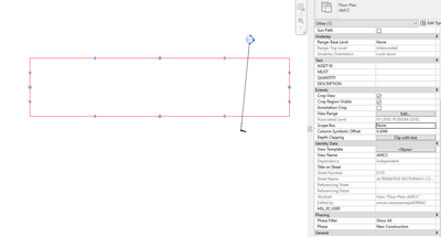

I need to know how can I have the blue points snap on inner rectangle?

Uncheck Crop view, turn on Scope box from VGO anno tab.

The view you show in the picture is still cropped. Uncheck Crop View box and uncheck Show crop region box, please.

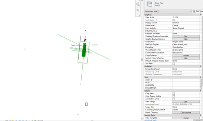

That's okay. Now type VG, switch to Annotation tab, turn on Scope Box category.

One of the green rectangles is the scope box that you need to resize.

this is the one, but still I don't have the grips on it to resize!

Do not assign the view with the scope box.  You have not resized the scope box then you are just back to the square one.
Just share the project then I will show you.

Now you need to go back to the view where you see a bunch of green boxes, find the one with the name AMCC, select and resize it.  After that, set your view to use the scope box AMCC again then you will see the difference.
Worst case scenario if you still can't do it, forget scope box, set the view to None and stretch the view crop.
