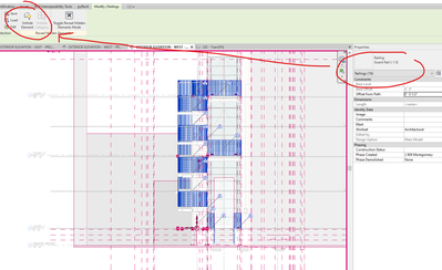

Vuxvix
yes i did.
Elevation view: iso mode - some element left out. ( reveal mode on)
3D view: for Rselect LOO
comback elavation view/ Rm/ Unhide in view/ only ( by filter) active.
Message 12 of 14
It should work:
- open isolation elevation view, reveal hidden elements (the light bulb)
- open the 3d view where you can select the objects you need to unhide, and select them
- go back to the elevation view, you should see those objects are still selected, unhide them then turn off reveal hidden elements mode
