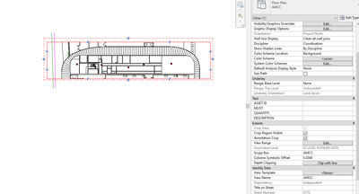

I need to know how can I have the blue points snap on inner rectangle?

Thanks for reply, but I meant the inner rectangle not the outer one.
I turned it off and on but nothing happened to the inner one and just off and on the outer one.

AH! I see. You have no interior grips! Interesting. I have no clue. I've never encountered that or heard of that happening.

Do you have a Scope Box on?
...you must.
Message 7 of 49
Set the view scope box to None.

By the way, a scope box normally is assigned to multiple views. So if you want to change other views with this scope box, you better resize the scope box itself.

Sorry again, but after turning off the scope box  I will get the grips but view will be disappear! and I need to work on view while I can see it in scope box to make it suit. Have you got any idea?

Turn on scope box in VGO annotation tab, set the view scope box to None, uncrop the view and you should see the scope box in order to resize it.  Another way is open another uncropped view to modify the scope box.

Yes, I did as you said, but still after untick the crop view and resize the scope box, when I turn scop box to " AMCC" (the name of scope box) again it return to the previous one I show it in here!

Are sure you resized the correct scope box? Look at the name of it when you edit.

I resized it.
