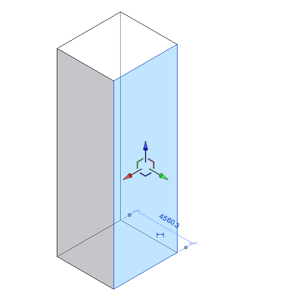

this is my intital shape

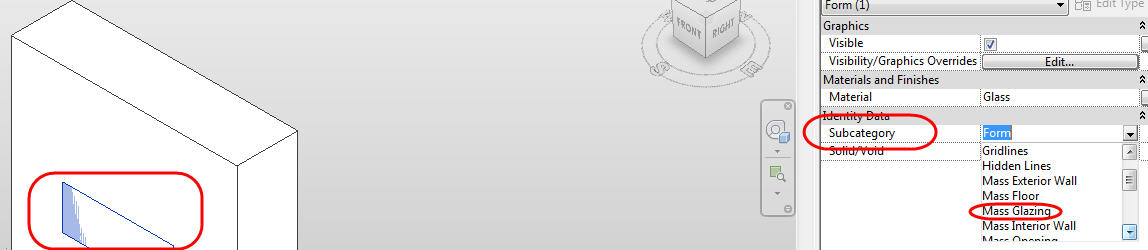

ensure subcategory is set to mass glazing prior to inputting into project environment...
see attachment.
