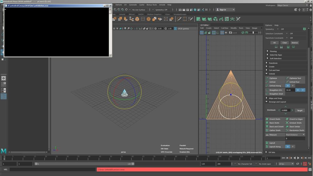

vilsaum
Please, I'm facing the same error here and I've tried the step that you've mentioned but is no working for me, do you have any other idea about how can I solve it?
If I try to use Unfold, Layout and Optimize the issue appear.
I've formated my computer and it worked for a while, but after some time this issue continues to appear.

same problem with unfold3D. i noticed a thing. i have 2 pc , one with Intel CPU i7 6950K and one with AMD Ryzen 3900X . on the i7 i have no problems with unfold 3D and it works perfectly, meanwhile on AMD it not works. i tryed to turn it off and on on plugin manager and nothing happened. i tryed also to uninstall and reinstall Maya and same... unfold 3D doesn't work.
Someone can help me?

For me to make Unfold3D work again I had to Untick Loaded and Auto load in the PlugIn Manager and keep it Unticked.....
Message 14 of 76
When I Unchecked"load" and "auto load" it works.
Don't know why but thanks

When you unload the Unfold3D plug-in it just uses Method: "Legacy" instead of "Unfold3D",
but even with Unfold3D plug-in loaded you can manual choose "Legacy" as Method for Unfold in the options for this tool.

Unchecking Loaded for the plug-in does NOT fix it, it just disables the plug-in and switches to "Legacy" instead of "Unfold3D" mode.
Having Auto load enabled has no impact on the current Maya session, it just auto loads the plug-in with the next Maya start.
