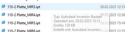

You are not alone. After installing Inventor 2026, my system started freezing and crashing. When I hover over the icon, the prompts appear,
but clicking it causes the computer to freeze. So I am not sure, the proms are the problem. Shortly after, Windows Explorer crashes.
I took picture with phone.
Everything works fine when I uninstall Inventor 2026 and revert to 2025. Windows and drivers are fully updated.

Update: Even with Inventor 2026 instaled, when the default app is Inventor 2025, Windows Explorer wokrs without isue.
Message 9 of 14
MartinPapez
I foud out, that I do not have the isue with I.2026, when the preview is switched off. With Inventor 2025 works the preview ok.
