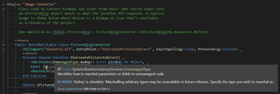

I'd like to know the correct way to resolve the "'AsAny' is obsolete" (BC40000) when create new project using Autodesk Inventor 2025 VB AddIn Template (PictureDispConverter class) supplied with SDK
How do I set Small and Large icons of AddIn button?

Yes VS classifies this issue as warning ('just' underlines the call with green curled and partially strikethrough it - definitely not something worth an attention 🙂 ).
UPDATE:
MS Copilot suggested to replace 'AsAny' to 'Struct' but then it stopped working.

This question is good point. I try to look at this and my solution is to overload OleCreatePictureIndirect method for Icon and Bitmap.
You can see the PictureDispConverter code on my GitHub.
Maxim-CADman77
For those interested here is the VB net version of Michael's code:

And I believe there are two more minor edits to the original code needed (use 'System.Guid' instead of 'GUID' in both Picture and Bitmap variants of the OleCreatePictureIndirect Function):
<DllImport("OleAut32.dll", PreserveSig:=False)>
Private Shared Function OleCreatePictureIndirect(pictDescIcon As PictDesc.Icon, ByRef iid As System.Guid, fOwn As Boolean) As stdole.IPictureDisp
End Function
Private Shared Function OleCreatePictureIndirect(pictDescBitmap As PictDesc.Bitmap, ByRef iid As System.Guid, fOwn As Boolean) As stdole.IPictureDisp
End Function
Dear @johnsonshiue
Could you, please, ask the Inventor team to make appropriate updates in VB Template included to SDK of further Inventor releases?
