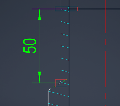

How to measure the distance between the intersection point of an edge in a view and the extension lines of two edges using API methods in Inventor?

ss13953642009
First, obtain the three lines to be annotated in the view, create the geometric intent for the first line, calculate the virtual intersection of the other two lines and create geometric intent for that point, and finally create point-to-point dimension annotations.Below is the code for calculating the virtual intersection in C#.
