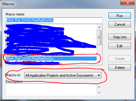

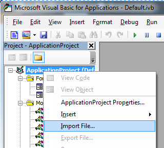

Import the "Print_Ref_DWG.bas" into a Module in VBA Editor, and import the "PrinterForm.frm" into Forms in VBA Editor.
This Macro looks for Inventor DWG and not IDW.
Change the text in the red circles to idw if you want to use IDW.
//Jesper

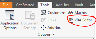

This is not a iLogic Rule. It's a VBA Macro.
Go to Tools -> VBA Editor.
Import the .bas file and the .frm file.
Run the macro from a Assembly File.
//Jesper

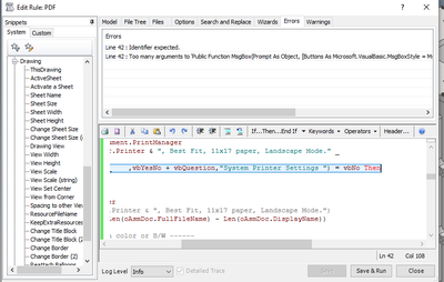

I tried to copy and paste this code into an assembly and am getting this error when trying to save the ilogic rule. Any suggestions?
Message 14 of 15
Ralf_Krieg
Hello
There is an underline in Line 42. Set the cursor behind and press Enter. That's it.
