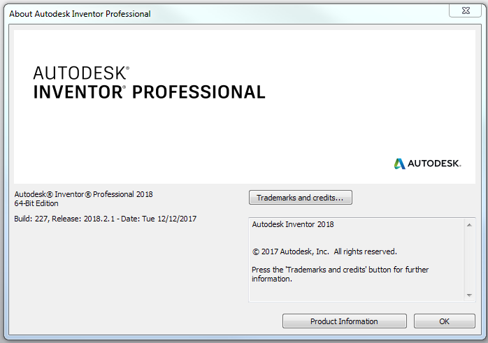

I believe I have the latest version:
I would recommend you run the latest updates (from the desktop app) on your users' system and come back to us if the issue isn't fixed.

AlexFielder
and what's the build number now? Same as mine or..?
(I ask because these patches 2018.2.1 & 2018.2.2 may address the issue, but then again they may not.)
