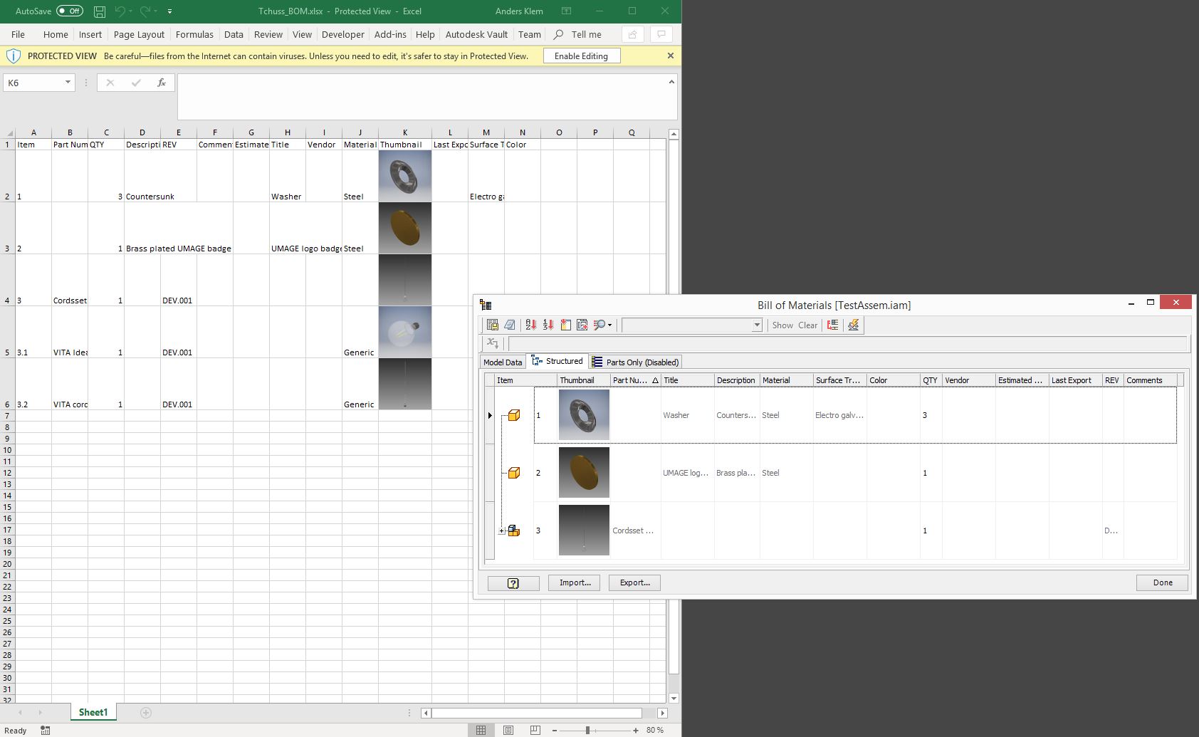

Hi All
I'm trying to export the "Structured - All levels" BOM view as an excel workbook. The code below sort of works, but it scrambles the columns. Check out the attachment.
Any help ideas how to fix this?
Cheers - Anders
Dim AssmDoc As AssemblyDocument
Set AssmDoc = ThisApplication.ActiveDocument
Dim BOM As BOM
Set BOM = AssmDoc.ComponentDefinition.BOM
BOM.StructuredViewEnabled = True
BOM.StructuredViewFirstLevelOnly = False
Dim BOMview As BOMview
Set BOMview = BOM.BOMViews.Item("Structured")
BOMview.Export "Test_BOM", kMicrosoftExcelFormat

what version of inventor are you using?
the file name is not complete?

philip1009
After setting up the columns the way you want in Inventor, hit the export button, this will export the settings for the BOM as an xml file.  Save the file where it can be easily accessible by all users.
AssmDoc = ThisDoc.Document
BOM.ImportBOMCustomization("FILE PATH AND NAME OF XML FILE HERE")
'Then finish export code.
Sometimes this does work, other times it doesn't.  It's been reported as a glitch to Autodesk many times, somehow something like this takes forever for them to find and fix.

The way I managed it was by creating a partslist on a drawing and export that, but then you don't have the Tumbnail.
If you use this a lot then try the NXTdim software. there is a trail version.
look at this: https://www.youtube.com/watch?v=7oH3jv_Q094

akAMYTB
Version is 2019.2. You're right about the filename. I just cleaned ip the code for posting to the forum. My real code has the correct filename.
Thanks.
akAMYTB
****... It didn't work for me.
