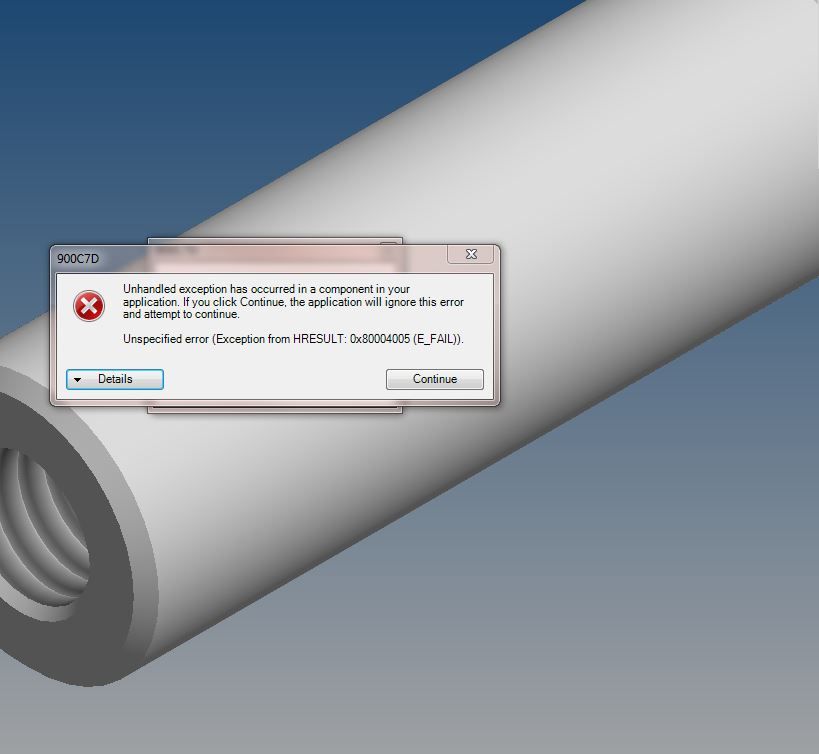

 I have looked this over and I can't figure out why it is giving me this error.
1st time I even seen this kind of error on ilogic.
I supplied the part I will warn you don't hit continue it will stick you in a loop and you will have to force close Inventor.
Now this is in a library folder it works if the part is in the project workspace but I can't have that they need to be in a library so they cannot modify the part by accident .
It works fine in 2012 as a library but not in 2018.

I have opened the part and made a couple of edits using 2018 and have no issues or errors.

Did you put it in a library and mapped in projects?
It works if it is in the project folder but not in library..

Since you said this is in a library folder, it could be related to the "bug fix" in 2018 which removes the ability for the API to modify library parts. In the past the API could edit parts in library folders that could not be edited manually. That issue is discussed along with a hidden bypass for the fix added in 2018.2 in the thread below.

In VBA, you now have to use:
ThisApplication.[_LibraryDocumentModifiable] = True
That also works in iLogic.

Put this line in it's own rule, run it, then try your code again:

No luck...
 Put it in his own did not work and would not let me exit so I had to task manager close Inventor..

last option could be:
this allows you to edit the Content Center part;
ThisApplication._LibraryDocumentModifiable = True
Don't forget to set it back to false for the Application
with:
ThisApplication._LibraryDocumentModifiable = false
Completed Code:
Dim fileName As String
Dim path As String
path = ThisDoc.WorkspacePath()
fileName = "filename"
ThisDoc.Document.SaveAs(path & "\" & "900C7H" & L_1 & ".ipt" , False)
doc = ThisDoc.Document
path_and_name = ThisDoc.PathAndFileName(False) ' without extension
iLogicVb.UpdateWhenDone = True
MessageBox.Show("Your file has been made", "SPACER")

OK that code works but needs to be the 1st rule in the list
