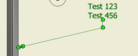

I am wondering if there is a way to center leader text over a vertical extension line.
So the text will read horizontally and the leader and extension will extend out from the bottom of the center of the text.
I have attached an example of what I am looking for (this was done using a workaround of a multileader without text and a textbox superimposed above it.
Thanks in advance!
-Matt

Curtis_Waguespack
Hi matthew.cassera,
What version of Inventor are you using? There have been some changes to this in Inventor 2017 I think.
In any case, try this:
Create the Leader and text.
Then select the leader landing line and drag it vertically.
Then add another leader.
And make sure the style has the option to justify the text is off (unchecked).
I hope this helps.
Curtis
Message 4 of 14
I am working with Inventor Professional 2016. As such, this method does not seem to work in this version.
As I drag the extension line to the vertical position the text rotates with it. Thanks, anyway. I will continue with a workaround.
-Matt
