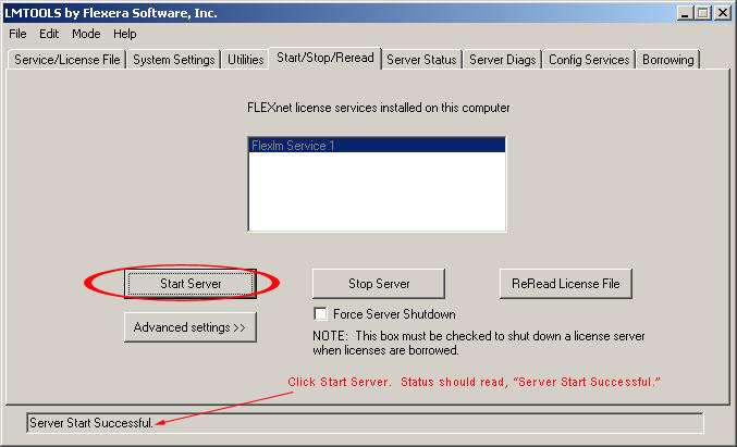

STEP 7:  On the Start/Stop/Reread tab, click Start Server to start the license manager service. The status box at the bottom should change to Server Start Successful.
STEP 8:  You can now verify that the license manager is working from the Server Status tab by clicking Perform Status Enquiry.  The status box should populate with information.  Scrolling down through the data, you should be able to verify your Autodesk feature codes and the amount of licenses that are available.

After following your tutorial, I got the following error message in Step 7: "VD is starting, please check vendor daemon's status in debug log".
After performing the Status Enquiry in the SERVER STATUS, I get the following error message:
Status
Flexible License Manager status on Sun 11/23/2014 12:32
[Detecting lmgrd processes...]
License server status: 8851@Queen_Rosa
    License file(s) on Queen_Rosa: C:\Program Files\Autodesk\Autodesk Network License Manager\License\LICPATH.LIC:
lmgrd is not running: Cannot connect to license server system.
 The license server manager (lmgrd) has not been started yet,
 the wrong port@host or license file is being used, or the
 port or hostname in the license file has been changed.
Server name:   2001:0:5ef5:79fd:100d:4f7:439d:272d
License path:  8851@Queen_Rosa;
FlexNet Licensing error:-15,10.  System Error: 10061 "WinSock: Connection refused"
For further information, refer to the FlexNet Licensing documentation,
available at "www.flexerasoftware.com".
Hostname and Ethernet adress are the same in both the LMTOOLS and the LICPATH.LIC.
Could you help me please with this issue?
Many thanks in advance for your help.
Message 12 of 14
TravisNave
LICPATH.LIC is not a license file.  It is a pointer.  You need an actual license file to configure your license.  If you have a network version, then you can do this.  If not, then you have installed incorrectly.
