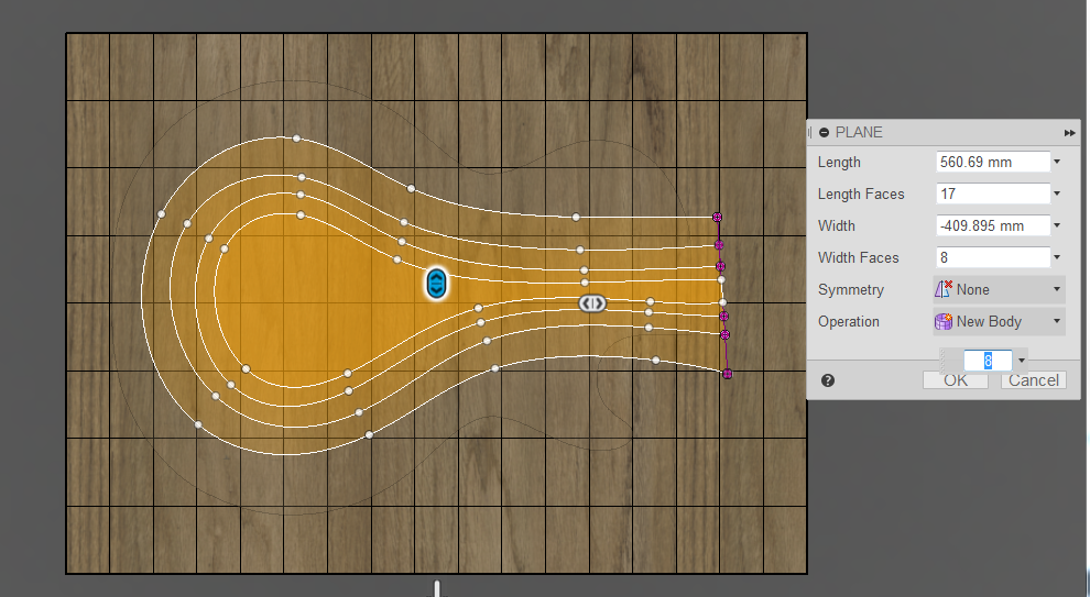

I do alot of woodworking with my CNC at home and have used different software to create 3D models of a Les Paul type guitar arched top.
I am having a hell of a time making a complex curve outlines shape that also has complex curved top surface.
I have no problem sketching the shape of the body and extruding a shape to the complex outline.  The problem is getting the arched top portion.  Any tutorials that may help me figure this out?

OK, the "eyeball" method.
Once you have your contour sketches set up:
create a Form feature, and create a Plane, bigger than the body.  I did not make my plane dense enough, I would have added more divisions.  This makes it more laborious to edit, but also more accurate:
Now, use Edit Form to tweak the TSpline body, and use the graphics intersection to help you determine when you are close to your contours:
This is the labor-intensive part.  But, it only took me about 5-10 minutes to get close.  With more divisions, it will take longer, but the result will be better.  You may be able to use symmetry to help, if your arch is symmetric:
This is the resulting body when you exit the Form Feature:
The rest is the same as above.  Split body using this surface.  Here is the result:
The model is attached, for your information.
