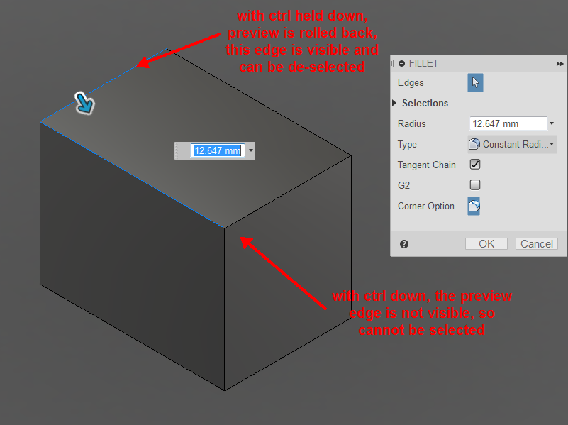

So, because in many systems, CTRL/CMD is used as a way to additively select more things, it seemed reasonable to also bind this to the "preview rollback" function in a command.  So, what Fusion does is:  when you hold down CTRL/CMD, the preview is rolled back, and you see the model in its un-filleted state.  In this state, you can de-select edges that are already selected, select new edges, and also are prevented from selection preview edges:
