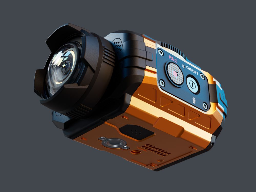

For rendering, I used Maya with the Arnold engine. A combination of a dome light and three disk lights was positioned to achieve balanced illumination. Below, you can observe the result of the lighting on the model without any textures applied.
I did not make any special settings for rendering and the changed values are shown in the screenshot below. I saved all the rendered images in PNG format and filled the background with a simple gray color in Photoshop. Initially, I considered taking the rendered images in EXR format and adjusting the colors and light intensities in Photoshop. However, I concluded that the output images of the rendering are good enough and do not need to be changed.
Final Thoughts and Future Enhancements
The final rendered model showcases the Ricoh WG M1 in its full photorealistic detail. As a potential enhancement, I plan to texture the camera screen to simulate it being powered on and create close-up renders to highlight finer details.
Additionally, I created a 360-degree video of the model to provide an immersive view of the design. This project not only refined my skills but also served as a reminder of the importance of reference materials, efficient workflows, and attention to detail in achieving high-quality results.
