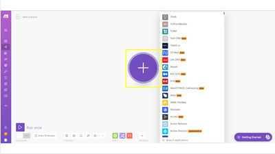

④First, press the plus button in the middle. Then, you can link various applications. However, no Autodesk-related applications are published.
So, let's create a custom one.
