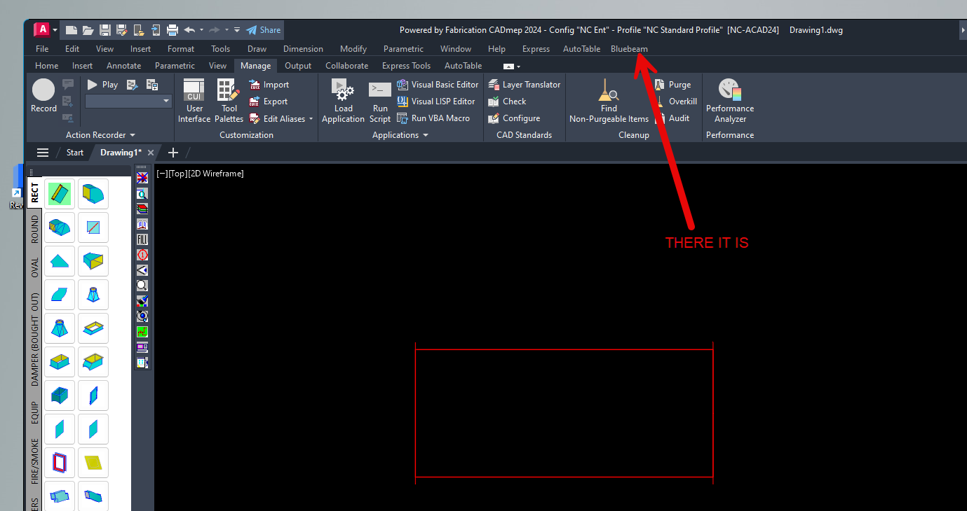

SI_Derrick_V
I also had to enable the "menu bar" on top of the screen "customize quick access toolbar" pull down.
