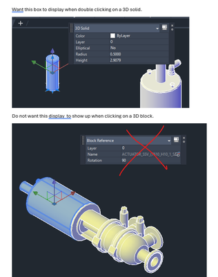

Just encountered this issue today. I have two AutoCAD sessions open and only one is having this issue. When I double click on an item, the "quick properties" box would pop up and display the radius, height, etc. of a 3D solid I have. But when I click on a 3D block, no box would pop up, which is what I prefer. But all of a sudden, this stopped working. So I searched how to fix and updated the QPMODE to (1) and the quick properties shows up like I want for the 3D solid, but now it shows up for the 3D block that I don't want. How do I fix this where the quick properties box shows up when I double click on a solid, but doesn't show up when I click on a block? See image example below. My second session of AutoCAD that I have open, it's working fine just like I want it to, but when I check the QPMODE settings are the same. So it must be a different setting that needs to be adjusted, I just don't know what that is. I've tried "CTL+SHIFT+P", but that turns display boxes off, which I don't want. Any help is much appreciated. Thanks in advance.

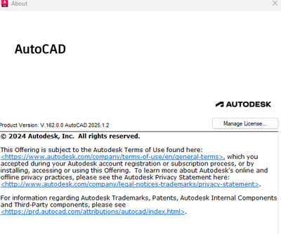

Both sessions of AutoCAD is in 2025. Below is the version I'm using is shown in the image below.
