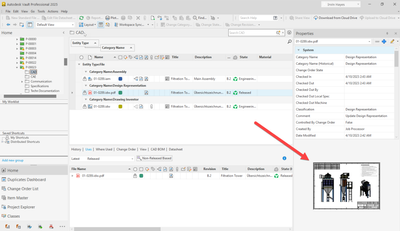

Would it be possible to increase the size of the thumbnail in the Vault preview window?
As it currently shows, it is very difficult to see what the drawing looks like, It just seems odd that there is such a big space for a preview yet there is only a tiny preview pane itself.

Thank you for posting the Idea. The thumbnail is an image embedded inside of the file that Vault extracts from the file during check-in. The size of the thumbnail is controlled and created by the authoring application. Vault is only able to extract what that application provides.

It should also be noted that the thumbnail is just that, not the preview itself.  If you click on the thumbnail you should get a preview that fills the window.  Assuming you are generating visualizations, and have your document previewers turned on.  If you need help with this, post in the Vault forums and we can help you get it set up.

Hi Cbennor, I am aware it is just a thumbnail & clicking it sometimes makes it fill the window.
I just thought that as the area is so large, why is it wasted with such a small thumbnail in the middle when it could have a much larger preview there instead, thus saving another click. A lot of our work for certain customers is very similar & finding the best look-a-like to copy saves a lot of time in the drawing/modelling environment. Being able to see the difference easily in the Vault environment would also save a lot of time.
Just my thoughts on it, You can do it in Windows explorer folders would be nice to be able to do it in Vault.

@chrisreynolds , You can change the default view of the Preview Pane. Go Tools -> Options in the menu.
Click the Document Previews button and check the box next to Autodesk DWF.

@ihayesjr Thanks, that works much better than the crappy little preview we normally have, Just altered the other workstations to match.
