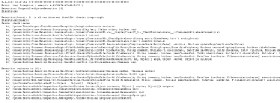

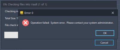

I have updated Vault 2022 to 2023 including 2023.0.1. The installation went smooth and everything worked fine untill check-in files. From Vault I have following error message:
check-in from Inventor:
Server Logbook:
Any ideas ? Thanks

What concerns me is what is mentioned in the server log:
Exception(Inner): There is already an Item with de same key added.
 (Translated from Dutch)
It looks like there something double, but what ?

Gabriel_Watson
It seems to me that something is getting lost in your property mapping sync, according to the logs there. That would align with a similar thread below, which may help solve this:
https://forums.autodesk.com/t5/vault-forum/error-quot-an-item-with-the-same-key-has-already-been-add...
You may have to open up a support ticket and show them your Vault property mapping and test without it enabled to confirm that is the issue.

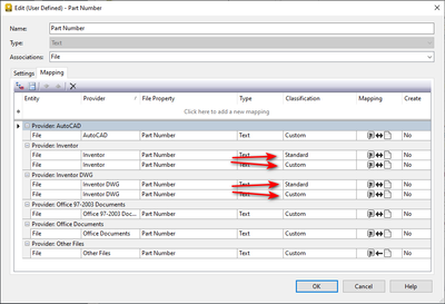

tobias
Autodesk Support find the double entry as follow:
Tools > Administration > Vault Settings > Behaviors > Properties
My part number had 2 mappings. I deleted the custom entries.
