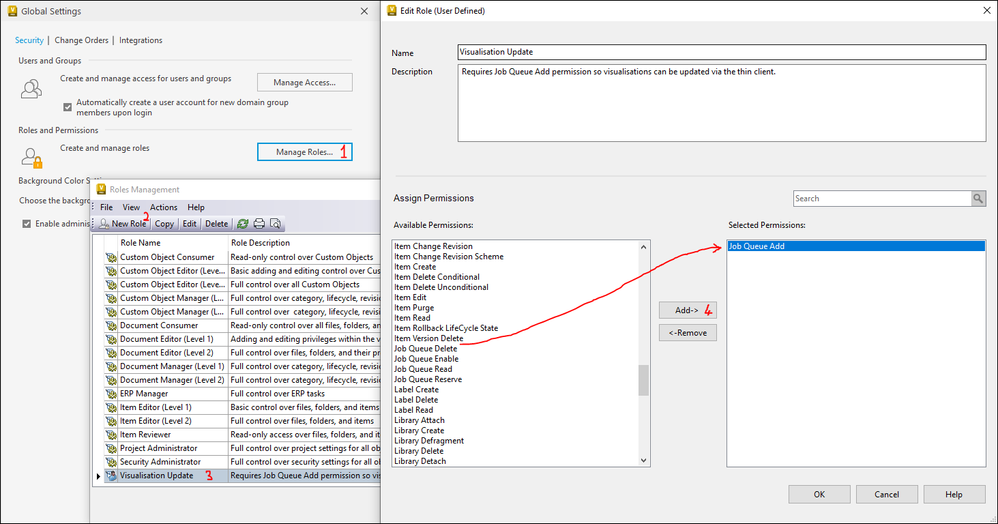

Message 9 of 9
Frank.HallWQLC5
Hey All,
I just want to address the comment above: "To run 'Update Visualization' command from thin client for a file (to add the job) - user needs at least 'Document Editor (level 1)' role."
A more cautious approach is only adding the 1 permission needed to "Update Visualization", rather than adding all the extra permissions that come with Document Editor (level 1). The steps to do this are shown below. In case the screengrab isn't available years from now: Goto Tools -> Administration -> Global Settings -> Manage Roles. Since the default Roles can't be edited, create a new Role and then add the Permission "Job Queue Add". This new role will then need to be assigned to the User(s) or Group(s) that would normally access the Thin Client (Vault online) with Read-only access.
