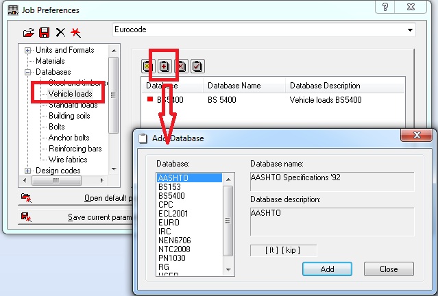

Add this database to project:
Rafal Gaweda
Message 25 of 45
Ok is it possible to do it automaticaly. Is there a file default to copy ?

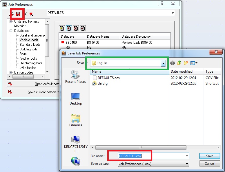

Message 26 of 45
Rafal.Gaweda
Autodesk Support
Autodesk Support
So you already know where the database file is located.
Add database to job preferences as shown in previous post, then save preferences:
File named ...cov will be saved in path which can be checked in the field marked by green rectagle below
Then copy it to different computers to similar folder, besides copying database file.
Rafal Gaweda

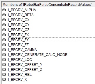

and this one : Load on bar ?
Message 34 of 45
Rafal.Gaweda
Autodesk Support
Autodesk Support
Set Recs = SimpleCase.Records
I = Recs.New(I_LRT_BAR_FORCE_CONCENTRATED)
Set Rec = Recs.Get(I)
Rec.Objects.FromText BarNumber
 Rec.SetValue I_BFCRV_LOC, -1 ' or global
 Rec.SetValue I_BFCRV_REL, -1 ' or real
'Select Case Direction
'Case "fx"
Rec.SetValue I_BFCRV_FX, value
'Case "fy"
Rec.SetValue I_BFCRV_FY, value
'Case "fz"
Rec.SetValue I_BFCRV_FZ, value
'Case "mx"
Rec.SetValue I_BFCRV_CX, value
'Case "my"
Rec.SetValue I_BFCRV_CY, value
'Case "mz"
Rec.SetValue I_BFCRV_CZ, value
'End Select
Rec.SetValue I_BFCRV_X, pos_x  'position
I have not used all properties (all shown below) of this kind of load in the example above.
If you need them use them accordingly.

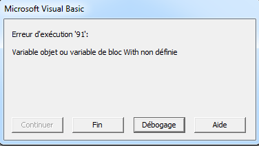

Ok I saw the file reservoir but my macro is not working. I have this error message :
The variable moncote is declared but it's not work anyway.
I don't know how to solv it ?
Message 38 of 45
Rafal.Gaweda
Autodesk Support
Autodesk Support
Do you have object no17 in model? Has it edge no 3 ?

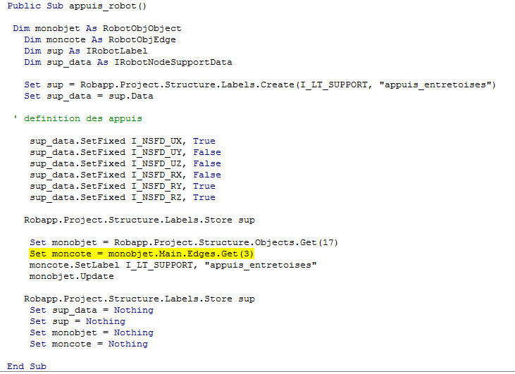

Message 39 of 45
Macro :
Public Sub appuis_robot()
 Dim monobjet As RobotObjObject
   Dim moncote As RobotObjEdge
   Dim sup As IRobotLabel
   Dim sup_data As IRobotNodeSupportData
   Set sup = Robapp.Project.Structure.Labels.Create(I_LT_SUPPORT, "appuis_entretoises")
   Set sup_data = sup.Data
 ' definition des appuis
    sup_data.SetFixed I_NSFD_UX, True
    sup_data.SetFixed I_NSFD_UY, False
    sup_data.SetFixed I_NSFD_UZ, False
    sup_data.SetFixed I_NSFD_RX, False
    sup_data.SetFixed I_NSFD_RY, True
    sup_data.SetFixed I_NSFD_RZ, True
   Robapp.Project.Structure.Labels.Store sup
    Set monobjet = Robapp.Project.Structure.Objects.Get(3)
    Set moncote = monobjet.Main.Edges.Get(17)
    moncote.SetLabel I_LT_SUPPORT, "appuis_entretoises"
    monobjet.Update
    Set sup_data = Nothing
    Set sup = Nothing
    Set monobjet = Nothing
    Set moncote = Nothing
End Sub
Message 40 of 45
Rafal.Gaweda
Autodesk Support
Autodesk Support
You have object 3 edge 17.
Object 17 , edge 3 - below
Set monobjet = RobApp.Project.Structure.Objects.Get(17)
Set moncote = monobjet.Main.Edges.Get(3)
Rafal Gaweda
