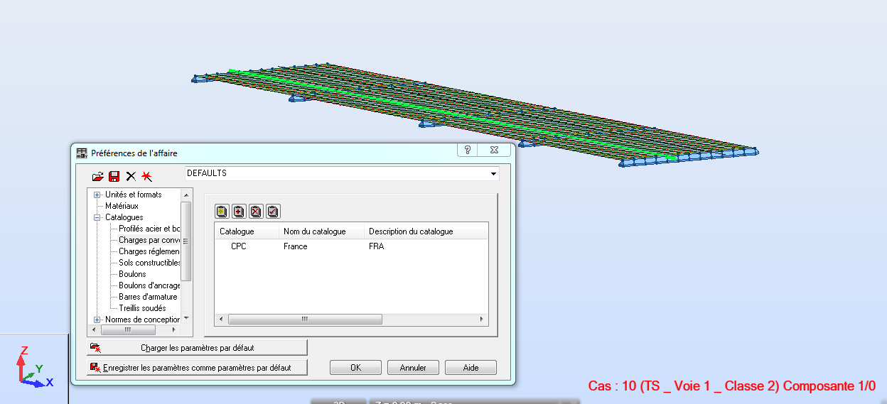

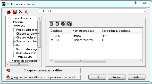

Message 41 of 45
@Anonymous_Adsk wrote:
Ok is it possible to do it automaticaly. Is there a file default to copy ?
So you already know where the database file is located.
Add database to job preferences as shown in previous post, then save preferences:
File named ...cov will be saved in path which can be checked in the field marked by green rectagle below
Then copy it to different computers to similar folder, besides copying database file.
when I generate a new model the data base is not the default one I want. I have to load the catalog by myself. That's why I have no moving loads on the slab. I have replaced the file DEFAULTS.cov in :
C:\Users\xxxx\AppData\Roaming\Autodesk\Autodesk Robot Structural Analysis 2012\CfgUsr
but it's not working.
Is that possible to load the catalog by default automatically ?
Message 42 of 45
