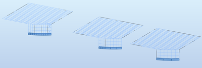

im trying to model arc slab on arc wall with arc discritizaton, but the joints are not connected to each other.
and also it give two joints at the same position
so what might be the problem ?

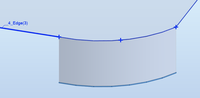

You have a different discretization for arc segments:

i did set the discretization for floor to 7 same as the wall.. but still same problem

same way, split the circular edge into multiple arcs of the same radius and redo the vertical panels

below, Split Arcs, a program to split all arcs of a contour, polyline, arc.
To use it, set the maximum length, select a contour (panel or cladding), a polyline or an arc and click ok
this program cuts each arc to the maximum length including if checked, the selected nodes.
