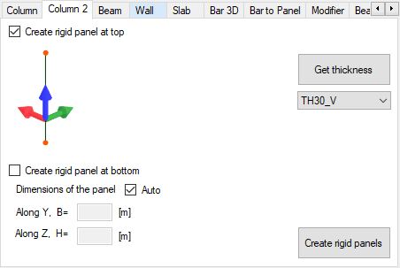

What's new in Spider Pro v.1.3:
• Now it is possible to create spiders for any cross-section of the column on the Column tab (user have to input dimensions of the column)
Several new features were added for rigid links generation procedure along the beam length on the Beam tab:
• User can create rigid links for any cross-section of the beam
• User can input the width value of the beam manually.
• Now it is possible to create rigid links on the start and on the end of beam
• Now it is possible to delete selected beams after creation of rigid links
Several new features have been added for drop panel creation procedure on the Slab tab:
• Now it is possible to create drop panels for any cross-section of the column (user have to input dimensions of the column)
• User can input the offset value manually, for example, zero or negative value.
• Now it is possible to create drop panels on the bottom of selected columns.

What's new in Spider Pro v.1.4:
Now it is possible to convert beams to shells in Robot with numerous settings:
• Beam with any cross-section will be converted with the dimensions inputted by the user. For RC beams dimensions may be obtained automatically.
• The label thickness may be predefined or automatically created with the thickness equals to beam height. In addition, a user may input a prefix for the name of the thickness label.
• Possibility to define desired panel calculation model, combining checkboxes FE and One-way.
• Possibility to assign linear releases

What's new in Spider Pro v.1.6:
• User can easily modify contour of the panel or opening using Modify Contour command on Modifier tab
• Now it is possible to adjust a number of nodes and diameter for circular columns on the Column tab.
• The alternative solution (“Brazilian method”) for rigid zones over the columns using slabs with enormous Young’s module was implemented. Many thanks @Rafacascudo for this idea. In the current version, the user has to create the thickness label and custom material by himself. Please check this link for more information https://goo.gl/okFsLd
