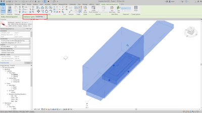

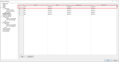

How do I get a 120/208V 3PH/4W panel to allow 120V receptacles to connect? I have added the 120/208V 3PH/4W Wye Distribution System in the MEP Settings and set the L-G Voltage to 120. The families  are provided and a screen shot of electrical settings with the error also provided.

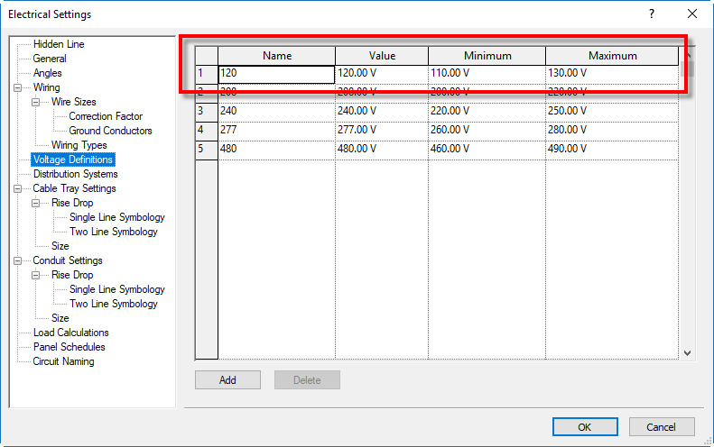

ricaun
I tested and works fine on the Imperial System Revit Template on Revit 2021.
Check if your Panel has the right Distribution. (Probably is empty)
And check your Electrical Setting Voltage Minimal and Maximum
I hope this helps.

robert.klempau
Hello @MasterSpark517,
Please check if the Type parameter 'BI_Voltage' has the correct value.
Check also the Voltage Definition.
set the Minimum and Maximum values right.

ricaun
You need to select your Panel and choose a valid Distribution System.
If this is empty your circuit is not able to connect to the panel.

MasterSpark517
I realize that. Since this posting, I've discovered there were too many circuits and too many panels with the same name; they were in different design phases. I ended up deleting several abandoned items and the connecting to panels began to work.
