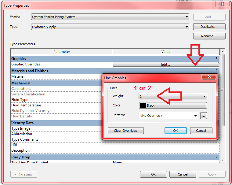

I think it is just one of those limitations in Revit. I tested various scenarios and settings and the one that came closest to a solution is the following...
Either by means of overriding the view VG with system filters or by means of overriding the Pipe System Graphic Overrides. Then also setting the Two Line Drop Symbol to "Bend - 3/4 Circle" opposed to "None" which you currently have.

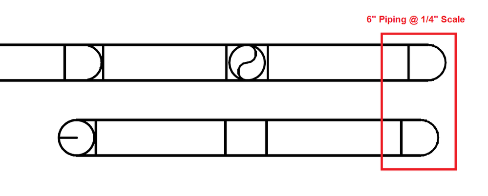

This is then the PDF result for a 6" Pipe @ 1/4" Scale:
