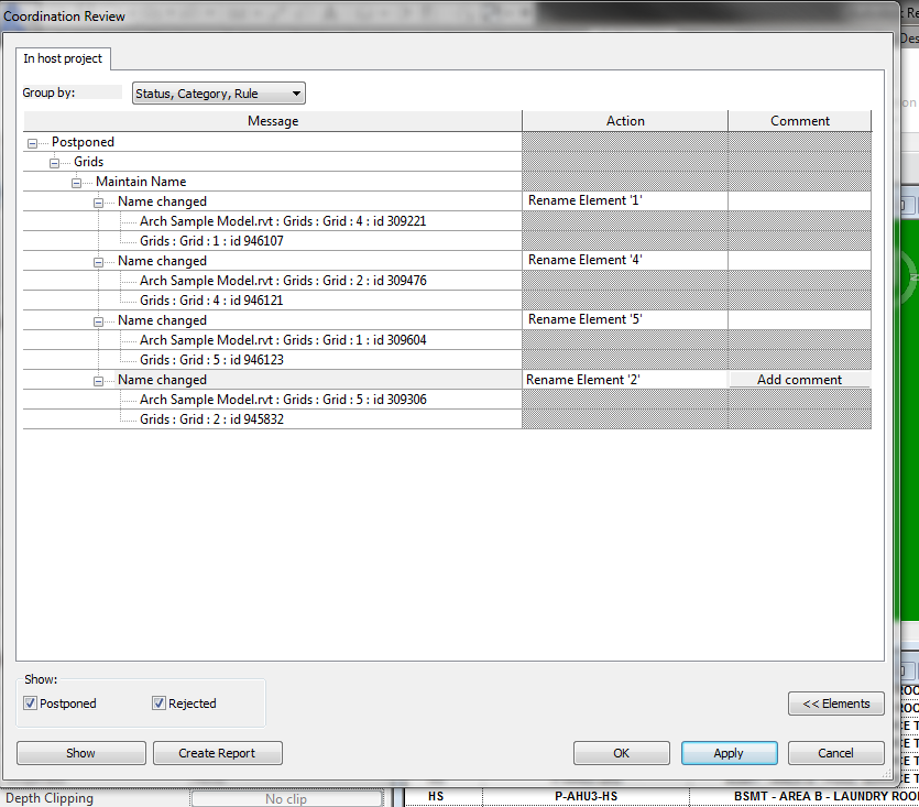

I dont seem to be able to update grid line numbers. The architect had his grids numbered out of sequence and I copy/monitored them in that way. Now he went and changed them all so that they are numbered correctly. so I went in to coordination review to update the changes but I cant because they are all the same numbers? This seems stupid to me. Is there a work around for this? Has anybody else had this problem?

Hi @revitworkbench ,
Try and change the number for all the copy/monitored grids in one shot rather doing it one by one and it should work. Because you are trying to change one grid number at a time it's not allowing you to do so as the grid line with the same number already exist in the model. Let me know if this works.
Message 3 of 11
revitworkbench
yeah I figured that, I also tried that. Doesnt seem to work for me. Can you get it to work?
Message 4 of 11
It's causing this problem because you might have changed the numbers for 2 grid lines and not all grids when you were trying to change the grid numbers. (I assume that from your initial post which shows 6 grids in the picture and the later image shows 4 grids in coordination review table), so either you can try to change all 6 grids at the same time or there is a way around which is little tricky.
  • Select all grids
  • Stop monitoring
  • changes the numbers (this is little tricky, as you can't rename/renumber grid if that name/number already exist, so you have to give some temporary number like 2a)
  • Re-monitor all the grids by following below steps
    • Collaborate --> Copy/Monitor  --> Select the link --> monitor
    • Select the grid line in your model, and then select the grid from linked model
  • Now the Revit is monitoring again that gridline
  • You have to do this for each gridlines - one by one.
Also, there is always option of deleting all grids and copy/monitor again if you are comfortable with that , and nothing works in your case (however I don't prefer/recommend this).
Let me know whichever works for you.
Message 5 of 11
Pick a single grid, rename it to '99' or some such unused number, then go through each grid in the Coord Monitor and rename them, starting with the one that wants to become whatever '99' used to be.  So for example, change grid '1' to '99', then change grid '2' to '1', grid '3' to '2', etc.
