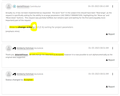

Allow to change order or A-Z (Z-A) sorting for project parameters
Now it is complicated to fill non sorted user parameters

Currently system families only support displaying the order of the parameters as A to Z, Z to A and default. Please include Move Up and Move Down options to reorder the parameters as required.

We are pleased to say that this has been implemented in Revit 2025! Thank you for your contribution to improving Revit!

Status changed to: Accepted
Our mistake. Not completely implemented yet. Apologies for my humanness! 😕

Previously, all created parameters were sorted according to the creation date.
From Revit 2024 all parameters are sorted alphabetically. This applies to both type parameters and instance parameters in the Properties palette. Alphabetical sorting is always to each parameter group. However, the built-in parameters in the group are not affected.
Unfortunately, there is currently no way to manually sort project parameters. Or at least enable a sorting rule by creation date.
New alphabetical approach, erases all erlier configured templates. And it makes an critical impact on data representation from Engineering and Management poit of view in the Projects after their update to Revit 2024.
