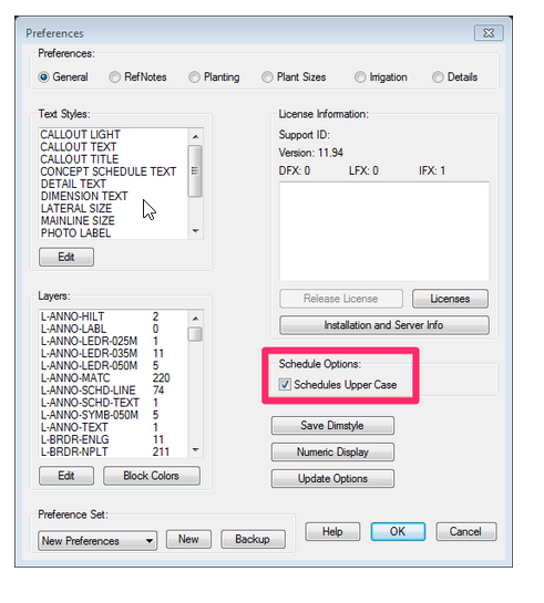

Can there be improvements to Revit Schedules to change the have a check box like in Autocad to make all text regardless of Parameter Title case? For example Revit System parameters are "Sheet Name, Sheet Number" along with other Revit System parameters can there be a check box that makes all text UpperCase so you don't have to Retype the parameter in all caps to keep consistent letter case?

Our company Graphical Standard is all Caps for Schedules, Notes, and Text on drawings. So this issue comes into play when I create sheet list or things with out of the box parameters but the designers/ end users make everything in that parameter Uppercase, except when the schedule is generated everything is cap but the ootb box parameters, I could easily have my users go back and retype them but that would be a ridiculous amount of time.

The options required are as follows (screenshot from AutoCAD)
Structural Usage seems to be hard coded within Revit, thus requiring the ability to format how the text case appears. It will look un-neat when some cells are "Sentence case" and others "ALL CAPS"...

This is a much needed feature, and the carpet-bomb approach of changing the names to uppercase is not a work-around. For instance, having room names in plan view, it's more appropriate to be title case, but on a schedule, with smaller text and a strict requirement that text be a minimum size (0.1" height for instance by many jurisdictions) the schedule must reflect that same text in upper case. AutoCAD does this very well in table formatting, also allowing you suffix, prefix, and format text at a row, column, or cell level.
