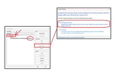

There is a solution if you plan to remove all design options or bring specific elements from a design option back into the main model. Simply select 'Option Set 1' (or the desired option set and temporarily make it "Primary"). This will display all the elements. Then, click 'Accept Primary,' which will transfer all elements from the selected option set back to the main model.
Important note: Make sure the design option you plan to bring back to the main model is set as the primary one; otherwise, the elements will be deleted.

@octavio.nilaUNGGM, that's not the point. That deletes ALL other options. The problem is when I'm first setting up the options and trying to sort out what needs to be in the option and what needs to be part of the main model, something that can frequently change as redesigns happen. Ideally I could move an object from the main model to an option, from that option to another option, and from the other option back to the main model, all without disconnecting it (which is what the cut / paste in same place does).
