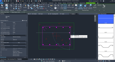

So first of all, I wanted to say that I know this feature is available in other 3rd party plugins. Here I'm talking about having this necessary feature as a native Revit Tool for people who are willing to do their task within Vanilla Revit without the need for another plugin.
One of the most common Rebar drawing cases, is column and beam rebars. Currently if you want to draw rebars for a column, you can't simply choose a rectangular patter, but you need to draw rebars in a line pattern multiple times, or draw one and copy that.
So you are forced to repeat a task multiple time to get it done.
Also if you want to stretch those rebars, you should constraint those rebar sets to each other, so you can stretch them together.
I believe that it is needed to have predefined rebar pattern. so user only decides the number of bar in two orthogonal direction, and Revit places them with equal spacing in the column perimeter.
For L shaped Column, it's easy too. Simply one rebar in each corner, then distribute the rest of them between corner bars.

This is my current routine:
1) Draw 2 rebar sets.
2) Mirror them across column axis.
3) constraint top of rebars to each other.
Problems:
1) time consuming and prone to human error in real life projects.
2) When you show the column in a elevation view, you can see only 1 of rebar sets (out of 4 separate sets) and when. you tag that rebar, total quantities of column rebars are not shown correctly.
M solution:
Having a rectangular layout for rebars so:
1) No need to draw longitudinal rebars multiple times or mirror them.
2) Also no need to constraint top of rebars to each other. So When you select 1 rebar and stretch it, all other rebars are stretched too.
3) For tagging purposes, when you select any of the rebars in any elevation view, quantity will be correct.
4) When select any rebar, all rebars are selected, then you can quickly change rebar size.
Do you have a solution Mr. @ovidiu_paunescu ?
I think a new <<Rectangular Layout>> for rebars can solve all of these issues easily. Please kindly consider it. Thank you.

I think for circular patterns it's straightforward, you have a set with bars going around the circle and you define the number of bars or spacing.
For the rectangular layout there are some considerations. You probably need to have bars at any corner of the stirrup, and then the rest of the bars distributed at a certain spacing between those corner bars.
You probably also need to have bars at intersections of stirrups in the same element (inner stirrups).
Maybe we could define a layout by selecting stirrups. If you select a rectangular stirrup, you get 4 bars at the corners plus bars in between. If you select multiple stirrups, you get bars in corners and stirrup intersections, plus in between.
Does this make sense?
How does propagate rebar factor into this? Does it help to reuse reinforcement you already modeled?
Some other considerations about free form rebar:
For circular columns, you can use free form rebar aligned distribution, selecting the outside faces and the perimeter circular edge as distribution path.
For rectangular columns, if you do the same you will notice that bars are just distributed by length and don't account for the corner position.

My suggestion which is a bit different :
step 1) Add a parameter to stirrups named something like "Ruling Stirrup"
step 2) Specify number of rebars in 2 orthogonal directions. For example 5 rebars in X direction and 8 rebars in Y direction.
step 3) longitudinal rebars are distributed  in X and Y directions with respect to the geometry of the "Ruling Stirrup".
step 4) Inner stirrups and ties are added after this by the user, based on the position of the longitudinal rebars.
