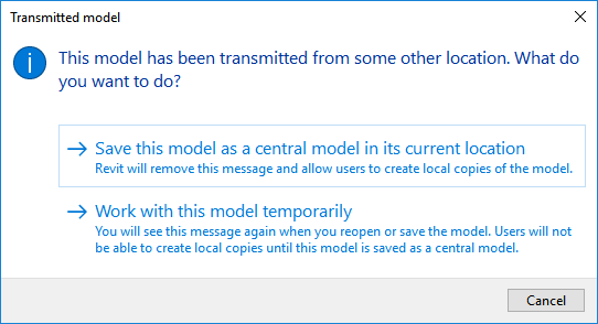

Signed in or not. Opening via Revit Open or double click from Windows Explorer (not zip file). Either v2017 or v2018.
In all cases it returns only one dialog:
We too pull frequently all our Revit Cloud Models from the BIM360 Team hub for backup purposes. All gave above dialog while opening.
