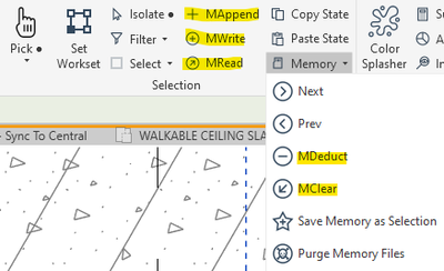

adaversa
I don't suggest this as a substitute of modifying "select previous" to re-select the last user selection rather than that selection as modified by a command error, buuuuuut......
For big selections (or to allow using "select all" on multiple types) I use the pyRevit selection tools. The ones highlighted below are the most relevant to the issue. Just remember to use them before using the move command!
