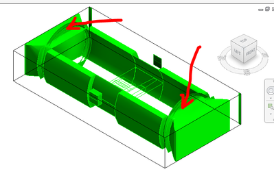

Radish_G
Hi Autodesk,
It will be great if the nested family elements can be cut by the void in the family editor.

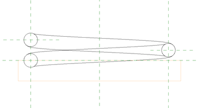

Recently I was developing a spring family and I want to cut the top and the bottom of the coil to make it flat.
But while I attempt to cut the nested family, totally cannot.
So I try to do it inside the source family I got the following error.
I attached a video as well, for better clarity.

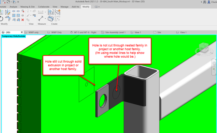

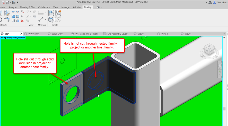

Chuck.Ross
I'm having trouble with nested void family not cutting a nested host family in a parent family when that family is loaded into either another family or project.
I have a Generic Model Family (c) - (used to create hardware that will be attaching a concrete panel to a steel frame)
Within that hardware Generic Model Family (c) there are:
  • a Face Based Generic Model Family (a) that consists of a void that is used to cut hole(s)
  • and a Generic Model Family (b) that is a piece of steel plate or angle etc.
Within Generic Model (c) I cut a hole through (b) with (c). - I use this approach so that I can make a Hardware drawing of C and use a schedule to list the counts and parameters of Steel and the Holes in a Bill of Materials.
Everything looks fine within Family (c), however, when I load (c) into either another Family (d) or a Project, the void no longer cuts the hole. - It is there, if the cursor hovers over the Hardware I can see the hole is there, it just doesn't cut... 😞
(Note, if the void family (a) is cutting a simple solid extrusion the cut persists, but not what I am looking to do.)
This seems like a bug to me, I can't think why Revit would want to behave this way.
Chuck
They would behave normally if the Void family and the 1st level Solid family is NOT shared.  But that would affect quantity take-off for those sub-components in the project.
Chuck.Ross
@ToanDN
Thanks for the reply. - It is definitely the Shared parameter that is affecting the cut. - I did a little experiment and isolated the issue to setting the family that is to be cut to be Not Shared. It doesn't seem to matter what hole family is set to.
Chuck

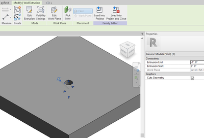

I would like to present the idea of allowing nested families to be cut by other elements in Family Editor, for example, voids created directly in the Family Editor of the parent Family.
The current functionality does not the elements created in the Family Editor to interact with the nested families.
With the new functionality, the cut could be made for the nested family with void extrusion made directly in the parent Family Editor, without the need to load it into the project:

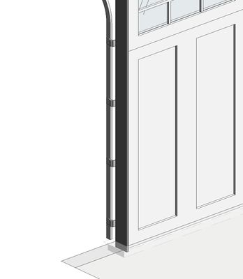

Mark_Engwirda
On top of what you are suggesting Karolina and along the same lines, I would really like to see the "cut with voids when loaded" option in families work as advertised e.g. having a void in the family cut into non-hosted parts of the model, like the example attached.
Example; a  garage door cutting a recess into a floor and for it to do this automatically
Currently, we can cut a recess into the floor by using a generic family object in the door family but we have to manually use the join geometry tool each and every time to get the desired result, but this would be far better for this to happen automatically as mentioned.
The desired result, the floor has been cut by the door family.
I appreciate that I am trying to cut part of the model that is not hosting the family itself, but this would be a very useful addition for families cuting into the model.
