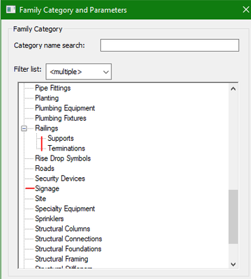

It would be nice to be able to assign rooms, spaces, areas to signage families, or have it as a subcategory for signage families similar to how railings have subcategories. This would then give access to all the built-in parameters.

@mhiserZFHXS I agree, what I was saying would be to have sub-categories for signage such as room, area, and spaces.
If the family is set to the room sub-category then you would get all the built-in room parameters so you could associate it with model text and other parameters within the family for formulas and what not.
Then when you load it into the project you can assign the room to that family using a drop down that lists all the rooms in your model.
It could also be set up in the family the same way profiles have a usage.
