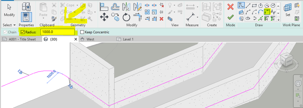

Hi Tony!
Have you already tried the "Radius" option?
tony.stuart
@KotairaKeila the suggestion wasn't around where the tool is, it was about how you can action it without clicking your mouse to place the radius,,,, at the moment based on your picutre, you would need to start the line command which you can quick key, but then getting to the radius button is a mouse click, then getting to the radius check box is another mouse click, then clicking into the radius distance is another. We should be able to quick key the whole process.
