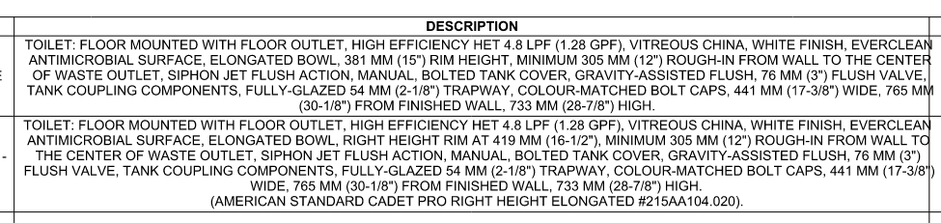

When exporting Revit sheets (Revit 2023-2026) to PDF using the built-in PDF export tool, text within Revit schedules often wraps incorrectly and extends beyond the cell boundaries. This results in misaligned or unreadable tables in the final PDF output. Within revit all the tables appear to be fine. This is not a font style issue as we are using arial. There are no modifiers in the font style that are affecting the margin. The parameter being pulled is text under a plumbing and equipment schedule in this case with a fair amount of verbiage. We have also seen this in electrical tables as well. Changing table column widths is not fixing the issue. Changing the table to multiline and placing manual hard returns is not ideal as this introduces issues when the table is reduced on a sheet. Export issues are not new issues and it needs to be addressed. We see similar results with CAD exports as well where wrapping and margins just are not doing what they should be.

Users are forced to rely on third-party PDF creators (e.g., Bluebeam, Adobe) to achieve proper text wrapping and formatting via the old "ctrl+p" menu. This adds extra steps and dependency on external software, which is inefficient for large-scale production workflows. The third party PDF creators are also issues when encountering long Revit or windows sessions. This results in misaligned text or font size or font swap in some cases. In those cases we have to restart Revit and or Windows  and try plotting again.

Anyway, as an annoying work around you can add a blank column to your table and hide the dividing lines, if you absolutely must use the native Revit PDF exporter.
