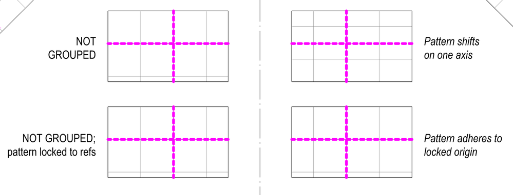

I conducted some testing of this issue. I thought I'd share the work here to assist in the improvement of the feature.
ORTHO FLOOR PATTERNS
Ortho Patterns FullOrtho Patterns Full
Ortho Patterns TileOrtho Patterns Tile
Ortho Patterns StoneOrtho Patterns Stone
ROTATED FLOOR PATTERNS
Rotated Patterns FullRotated Patterns Full
Rotated Patterns BathroomsRotated Patterns Bathrooms
Rotated Patterns TileRotated Patterns TileRotated Patterns StoneRotated Patterns Stone
