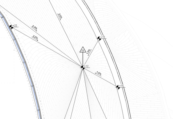

This has been a problem for years!
When the floor is sloped, the pattern get's all wonky. Placing a filled region on top is a dumb way of doing it, if the profile change, you have to go update all the filled regions. We prefer to use the live model and not put a band-aid on top.
Autodesk please fix!!

@Intuos5 I did a rendering of the tiled floor examples and it's not pretty.
The align texture tool doesn't help either.

@Mark_Engwirda  if you facet your floor, and the faces are not all in the same plane, some faces will typically tilt at a steeper angle than others. That means that viewed from above, the same patterns is going to appear shorter on some faces than on others (if you have a face at 89degrees, the pattern would look much shorter from above then on a face at 0 degrees). This is one of the reasons that not in many cases, it's impossible to make a fully matching pattern on a faceted floor.

@Intuos5  and @pieter4, I would think that it has to be a model pattern if we are modelling.
The main complaint is where the hatch pattern goes completely bonkers e.g. the pattern deforms into an arc as per the original posts.
The second issue is the alignment of the pattern, how does the pattern decide which edge of the model to follow?
You would think that it should follow the alignment of the original pattern as a default so all of the patterns match, even if they do become shorter due to the slope, I believe that it's important that they do.
The third issue with model patterns is not being able to adjust the alignment in a 2d view on a faceted face.
If you need to rotate the pattern you can only rely on the rotate tool which is a little tedious, and not the align tool which would be far more practical.
The align tool also doesn't work where the pattern appears to be shorter due to the slope unless you go into a 3d view, surely this would be an important benefit if we could do this in 2d views.

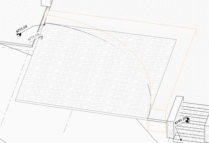

I appreciate the teams work on this issue and am looking forward to additional releases. I have downloaded 2023.1 and I'm not sure the issue is resolved. See my examples below of a rectangular shaped floor that I modified to test this feature. The drafting pattern is noticeably warped and the model pattern appears to still have warping/alignment issues. The model hatch at least looks presentable compared to a curved shape, though could still use some improvements. If it is in fact fixed for non-curved shapes, is there a setting to address the hatch pattern display that I may be missing?
Thanks!
Mike

@kimberly_fuhrman-jones I have found a workaround on curved sloped surface......(1)draw surface as rectangle (2) slope surface as required (3) create in place component (4) draw void (5) cut geometryCurved Slope Floor Void.pngCurved Slope Floor Final.png
