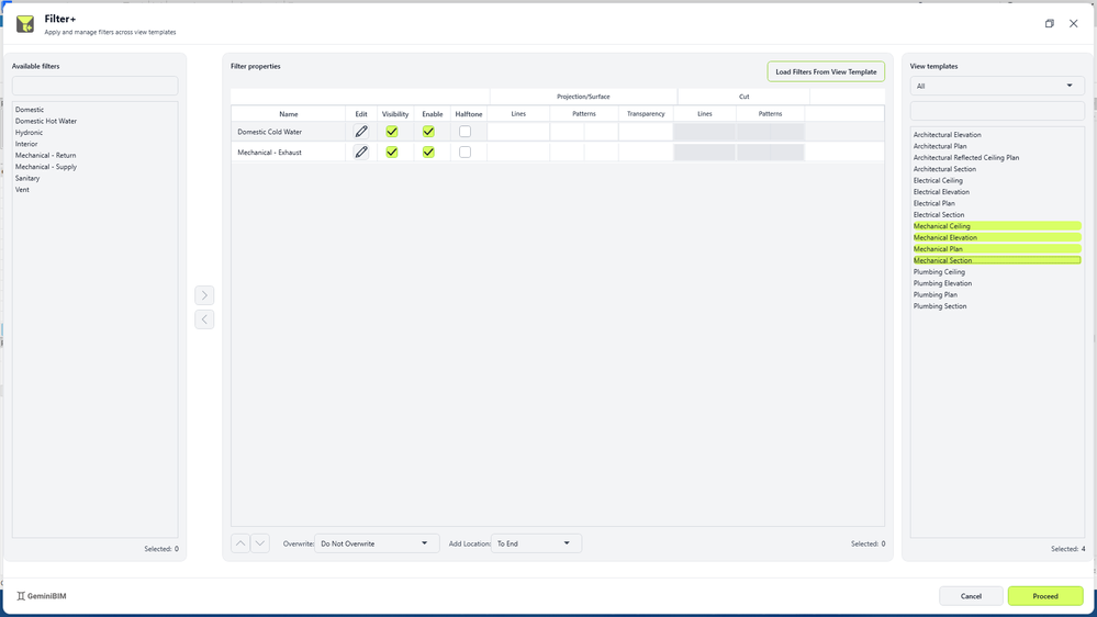

Full disclosure, I'm one of the founders of GeminiBIM, but until Revit adds this flexibility out of the box, we've got you covered: our ADD FILTERS + add-in lets you bulk add or modify view filters across multiple view templates in one go, and TEMPLATE TRANSFER lets you push view template settings from one template to one or many others. Between the two, you can apply a set of filters as a group across your templates today — which is essentially the workflow being requested here.
You can find both on the Autodesk App Store at https://marketplace.autodesk.com/apps/8446286a-d67e-4b76-8cb2-2841015bed57?priceId=ec2be252-a3f6-4d.... Hope Autodesk ships this natively soon, but in the meantime this might save folks some hours.Filter Pluse.png
