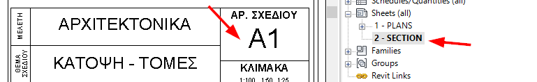

I have a project and I create 3 different new A1-sheets.
In the title block of every A1-sheet, I want to add the same Shared Parameter named: "Example".
Now every time, I go for example to the first sheet, in the field "Example", I would like with a simple clic to put the mouse cursor and write down "Name1".(This already works,but....)
Like it's structured Revit now, automaticly all the other sheets, will have named the same field: "Example"  in  "Name1".
I would like to be able to have the possibility to write down on every sheet "Name1", "Name2", "Name3", without having to go every time and create a new shared parameter. I don't know how many sheets I am going to create for every new project.
If cannot be done with the shared parameters, is there any other way?
Sincerly thanks
George

If a set a Shared parameter named Ar.Sxediou, I would like on every different Sheet like: 1-Plans, 2-Section and every other I will create, to be able to have in 1-Plans: A1   into 2-Section: A2  and in the next that I will create A3, A4 and so on....

 Hello mhiserZFHXS, no I do not what to assign it automaticly. I would like to have the possibility to create a Shared Parameter, named as an example: "TypeofPlan" and insert it with a text label on my template sheet. After that, every time I put the cursor of the mouse on the field "TypeofPlan", I can write whatever I want. Now in the next sheet I would like to have the possibility to write something different, but if it's a shared parameter like now, Revit change automaticly the field with the last my modification, in all sheets. Hope I could explain myself.

Change the category of the parameter from 'Project Information' to 'Sheets'.
Keep the parameter as instance. Each sheet can then have a different value.
When the parameter is set to 'Project Information'  (even if it is an Instance parameter) you can only have 1 value per project.

changing the parameter in 'Sheets' like you suggest, I have tryed and works very well.
Very good!!!!
